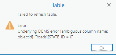

But when I create the join, it fails:
Failed to refresh table.
Error:
Underlying DBMS error [ambiguous column name:
objectid] [Roads][STATE_ID = 0]
The problem is: ArcGIS Pro hasn't given OBJECTID a prefix in the joined FC's definition query.

If I manually add the prefix to the joined FC's definition query, then it works as expected. The error goes away.
