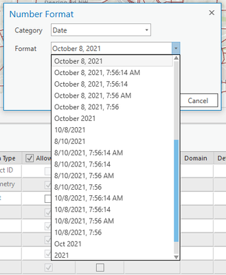

Hi @MicheleH1_DNReply I ran across this idea this morning and wanted to share that in Pro 2.8 you can apply a date format to fields.  See https://pro.arcgis.com/en/pro-app/latest/help/data/tables/format-numeric-and-date-fields.htm#GUID-04...
There are a lot of preset options as well as the ability to customize per the help topic above.
Does that resolve this issue?
MicheleH1_DNReply
Thanks for that Kory,
That will be helpful in the cases where we have created a template project and people are creating a copy of that to do their work.  Unfortunately this only covers a couple of scenarios.  In most cases people are creating their own projects and pulling the data in fresh each time so if the setting isn't a global ArcPro setting or set in the database (sql server) itself then this doesn't help much. I can however let people know that is there whenever they whinge at me! 🙂

Thanks for the clarification, @MicheleH1_DNReply So for an individual user, it is possible to set the date time format as needed, but you are looking for a way to set that at the application level and deploy to your organization.  I added a comment over here: https://community.esri.com/t5/arcgis-pro-ideas/migrating-arcgis-pro-options-settings/idc-p/1106396#M...
