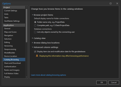

Also, under Project > Options > Catalog Browsing you may want to change this setting to "Complete path" instead of "Folder name only".
Before:

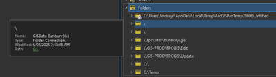

After: (note the missing drive letter names for network drives but not local drives - no idea whats going on there)
LindsayRaabe_FPCWA
I've just done a bit of testing myself on this relative vs absolute pathways thing and I'm even more confused now than I was before! It seems that data stored to a local drive (e.g. C) is updated when a project is Copy/Pasted but data on a Network Drive (e.g. G) is not. This isn't what I read above. UNC pathways also remained the same (as expected).

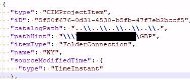

This is how folder connections are stored:
  • Under the hood, each folder connection is stored as a relative path. This one is "Go up 5 levels". AlfredBaldenweck_1-1738952875350.jpeg

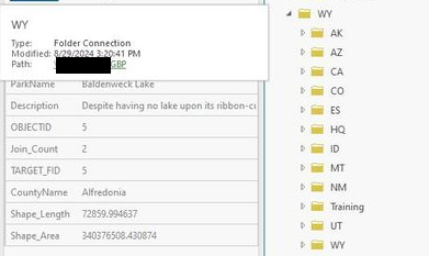

  • Then, on opening Pro, it reads it and resolves out the path as the pathHint AlfredBaldenweck_6-1738952992889.png
  • The name is entire separate and based on what that relative path resolved to when the connection was madeAlfredBaldenweck_3-1738952875351.jpeg
  • So, what ends up happening (real project of mine) is you open up Pro and it keeps the name that it already had. (That is, it says "WY", but is actually pointing to "GBP", the parent folder of "WY").
If the path is a direct parent of the APRX, it'll have this issue.
Otherwise, it appears to resolve the relative path, see that it doesn't exist, then check the path hint and run with that, instead. I was testing something along these lines and noticing that a lot of folders are the same after moving because they're to the side of the APRX rather than above.
