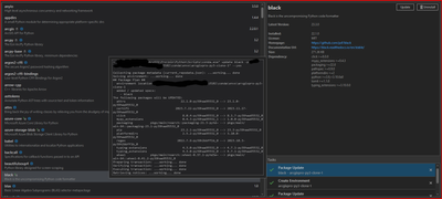

The Python environment Package Manager is a great tool for managing the Conda environment, but it can be very frustrating to try and determine which Conda packages can actually be upgraded using the Package Manager. Presently, any Conda package that has a version available on GIT Hub (or wherever) that is greater than the Default environment, shows the upgrade icon. But when clicking the "Update" button for the package, the system will go through all steps for upgrade, possibly updating all the resource libraries for the package, but will not actually upgrade the package itself.
-Update button clicked...
-After the update...
