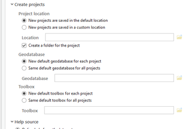

jmaxwell_braun
Thanks @AmeliaBradshaw! Does this work for creating a new geodatabase for each project, or only if using the same geodatabase for each project? I don't see an option to specify a mobile geodatabase for the "new geodatabase for each project" option in 3.1.
feralcatcolonist_old
Agreed, @AmeliaBradshaw I would expect an option here to specify the type of geodatabase to be constructed with each new project-- --the "new default geodatabase" is always a file geodatabase.
KoryKramer
@jmaxwell_braun and @feralcatcolonist_old This idea was to use a mobile geodatabase as the default and in 3.1 that is fully implemented. That is, a mobile geodatabase can be set as the default geodatabase and that can be set to be the default for all new projects.
Wanting the option to create a new mobile geodatabase rather than a file gdb whenever a new project is created, though seemingly similar, is a different request. Please submit a new idea for that. It looks like the team is already going to add an issue to the backlog based on this discussion, but it will be best to create a new idea that we can link to that.
