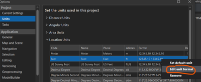

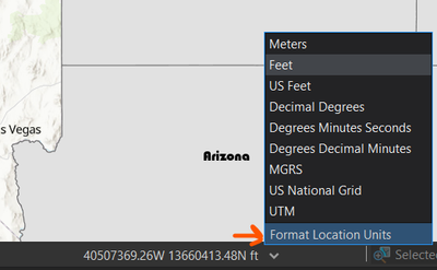

It looks like if you format your location units so that you don't have thousands separators:
You can then get really close to doing this workflow using the Copy Coordinates command from the right-click context menu on a map:

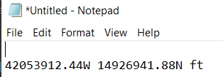

You'd get something like this
where you could then take either the lat or lon as needed.
I understand this isn't the exact implementation you're asking for but wanted to share in case you were not already using the Copy Coordinates workflow.

@KoryKramer  Yes sir, that's very close.  Also, trying to avoid the suffix text and going to Excel, Notepad or Word before going to the final destination.
