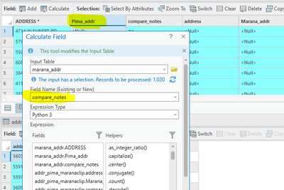

@KoryKramer  I have found another issue with retain the previous field calculations.  I have two fcs in a file gdb and have joined them - I calculated the "compare_notes" field and closed the window.  I right clicked on the "Pima_addr" field to open the field calculator and when it opens the field is still set to "compare_notes."  I haven't noticed this before so I think it might just be when you join tables, but I'll test a bit more and submit it as a bug.
