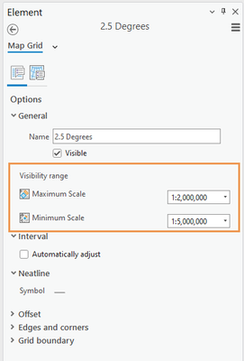

In ArcGIS Pro 3.3 grids and graticules have a visibility range you can set. The grid will only be visible if the map frame is within that scale range.
