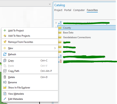

We have the option to add an alias to connected folders in the catalog pane, but we should be able to do this for our favorites, too!
Currently, there is no option to create an alias for your folders stored in favorites:
This would be a great addition so people can create an alias for a folder that is more relevant to them or makes more sense. Typically, folders in favorites are used across organizations for data so the folder names can not be changed.
Additionally, you can not add special characters into alias names (\ / : * ? & " < > | ). It would be great if some of these could be allowed, especially slashes (/) This way, there would be the option to name an alias with part of a file path (like D:/GIS/Data/Project/Deliverables).

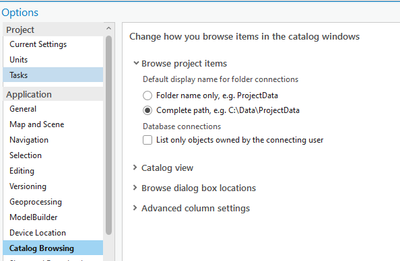

I found a secret in the Pro settings, if you go to the catalog browsing section and turn on "complete path", any CONNECTED folders will show the whole file path to the folder. this does NOT work for the favorites tab.
This is a good start, but an alias with slashes is still awesome, as well as an alias/file path in Favorites. Sometimes, you don't want the whole file path for privacy purposes. Therefore, please still find a way to have aliases in favorites and connected folders with special characters!
