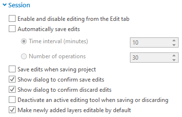

Editing being always on by default is especially confusing for new users (i.e. learners), who can accidentally 'engage' edit mode through simple attribute table work like sorting, clicking on a row, etc. This greatly impedes other workflows they might want to do when learning how to use ArcGIS Pro. In many other use cases, having editing 'on' by default could result in unwanted edits, confusion, or broken data.
There is an option to return to using edit button, which must be enabled in the options -> editing:
This should be checked 'on' by default to protect data and support users unfamiliar with editing. The 'work' of unchecking this box should fall on experienced users who know what they are doing with their data and have more experience with editing data.

Thank you for responding. It is certainly not checked on by default - I can confirm this on 40+ installations on workstations at my institution, and on my personal install, which I screenshotted above.
Working from the Table of Contents is nice, of course, and often how I would work in Desktop - but with editing defaulted to be on, it isn't very helpful to have to turn it 'off' for each layer.
