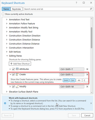

In ArcGIS Pro 3.2 there is a new experience for viewing and customizing keyboard shortcuts (you could still do most of this in older versions, but they were called "Accelerators").
To open the new keyboard shortcuts dialog, hit F12 on the keyboard or click this button on the Help ribbon:
(another way is through the backstage options on the "Customize the Ribbon" page)
This brings up this new dialog where you can see all of the out-of-the-box shortcuts, plus add your own. Editing has quite a lot - including one to open the Create Features pane (that you can customize, if needed):

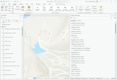

Once the Create Features pane is open, you can search for the desired feature template and activate it. Once you activate a template, the template's default tool becomes active (but the default tool can always be changed within the template properties, if needed) You can even have multiple templates that create the same type of features, but each with a different default tool 🙂

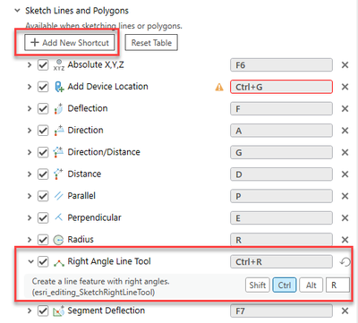

You can also add custom shortcuts to activate the different tool types. For example, if you want to add a shortcut for the Right Angle Line Tool, add it here:

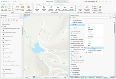

An option would also be by default suggest the feature selected in TOC for editing. and as mentioned with the ribbon (and this applys to all parts of pro) keep the dialogs together.
If I'm following, you can do this already by checking on the 'Contents Selection' filter within the Create Features pane:
Here is a gif of how it works:
With this checked on, now when you select a layer in Contents only the templates for that layer appear within Create.
(If I misunderstood let me know)
