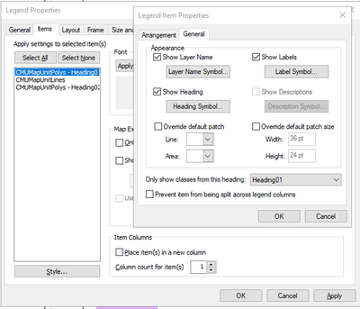

Can we have the "Only show classes from this heading" feature that was available in ArcMap back?

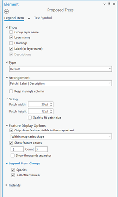

HelenCooper
It's slightly hidden in the 'legend item groups' at the foot of the legend panel.
IlkaIllers1
Interesting, I do not have that option... I am on version ArcGIS Pro 3.2.2, this should be included, right?
IlkaIllers1
Ok, if you only have one heading it doesn't show anything there... makes sense.
