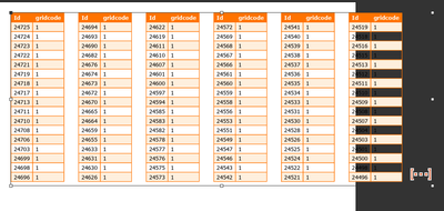

So if I insert a Table Frame to a layout and then increase the size of the table then I see weird behavior of repeating columns as shown below. Is this a bug or can it be fixed?

This is expected behavior. The screenshot provided (thanks for that) shows the overflow ellipses ([...]) at the bottom right hand corner of the table frame. This indicates that there is not enough space to display all the data for the columns/rows in the current bounding box of the table frame.  As you make this bounding box larger, there will be more space for more data (columns/rows) to draw. Likewise, if you make the box smaller there will be less room and less data will display.
What displays also depends on table frame and table frame columns settings such as the selected table frame fitting strategy and font sizes.

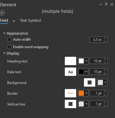

@TomBole thank you for the quick response, so when I extend the bounding box, shouldn't it expand the column widths instead of repeating the columns? Never mind, I found how to fix that > uncheck auto width and change the width of the columns. But to restrict the number of rows, say show only 1st 10 rows, do I need apply a filter(s)?
