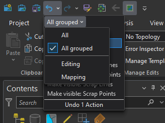

@KoryKramer I've never noticed that little filter option in the Undo menu! This alone will be very handy in the future.

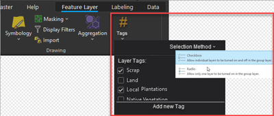

In saying that, the idea that layers can be grouped in a manner that doesn't affect their Drawing Order (i.e. by a Tag for example) is a good one. It could be implemented as a separate "List by..." option in the Table of Contents (i.e. List by Tag) and the tags are applied in a drop down on the "Feature Layer" ribbon.
If layer has multiple tags assigned, only 1 needs to be selected to make that layer visible. The layer will remain On in the map until all assigned Tags for that layer are turned off.
Assigning tags to a Layer:
Turning Layers on/off by Tag in Table of Contents:
The user could be given more control by implementing the Radio or Checkbox options to enable single or multiple selections in the Table of Contents "List by Tag" pane

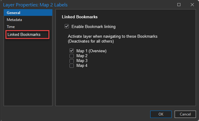

In addition to my previous comment on layer tags for non-display order grouping, I had posted an Idea here (Link Element & Layer Visibility to Bookmarks - Esri Community) which I've updated to be Element specific, and have moved the Layer portion to this comment to support this idea.
IDEA: Add function to link Map layer Visibility to Bookmarks.
I see this working by having a list of checkboxes on a new section of the Layer Properties window (or maybe in the Feature Layer ribbon instead) where you can enable Bookmark Linking and set which Bookmarks would make a layer visible when navigating to the Bookmark. Layers would be turned off when a non-checked Bookmark is selected. Manually moving/changing the map extent would have no effect further effect.
By extension, this could be connected to the Bookmark type of Map Series.
Bookmark Linking functionality summary:
- If not enabled (not checked), the layers remain as per what you last set them in the Table of Contents (on or off) when you navigate to a Bookmark.
- If enabled (checked), then the layers would turn on when a checked Bookmark is navigated to, and off when an un-checked Bookmark is navigated to.
- If enabled and no Bookmarks are checked, then it would always turn off when navigating to any Bookmark. This could be a useful way of ensuring that "reference" layers don't display on final map products.

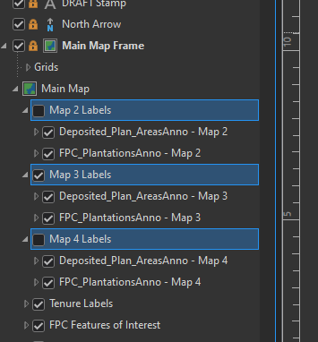

This idea is similar to the Page Query function where features are filtered by map series, but applies to a whole layer (or Group Layer as per my example below). I have a layout and am using a series of Bookmarks to focus on different views of a property - an Overview and then 3 Focus maps with more detail. I tried using Page Query with a Bookmark map series, but that didn't really work (I don't want to hide features - just labels. To achieve this I have exported labels for 2 layers to different sets of Annotation for each bookmark extent. I've then grouped them by Map Name so I can turn them on and off as I move through the Bookmarks.
This would tie in with the other Idea linked above regarding Elements to dynamically update layers and elements as you move from Bookmark to Boomark.
