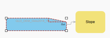

Function Chain - the source is the DEM layer!!!:

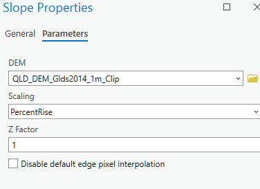

and Slope properties shows the correct raster source (which is in the default gdb) but you have to 'find' it again and apply it:
and then lose the custom symbology and legend text!!!
