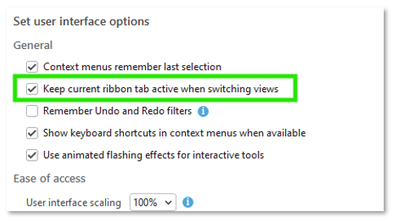

This is planned for ArcGIS Pro 3.6.
The Keep current ribbon tab active when switching views option will be off by default:

@MichaelGrossman will this option be exposed in Pro.settingsConfig?
