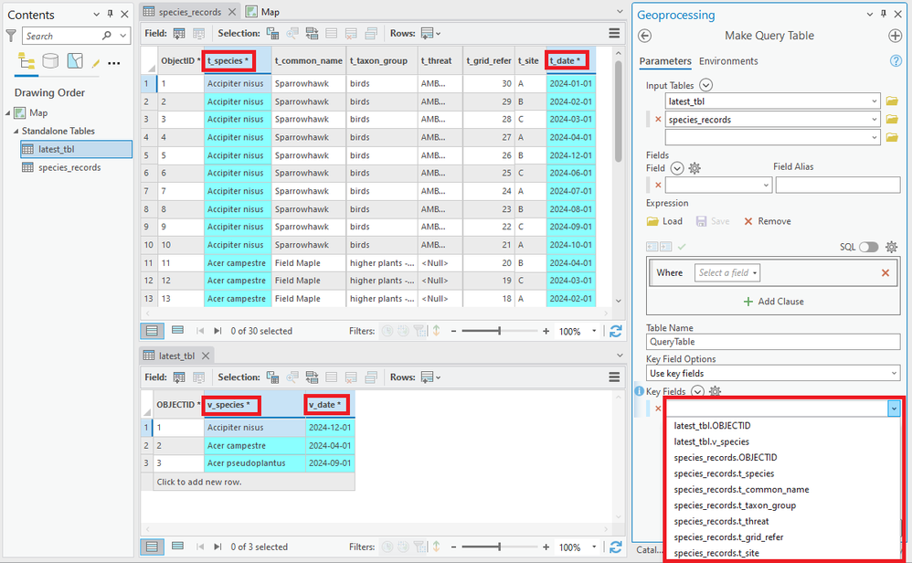

It's too bad it doesn't let us join on date fields. I wanted to join two file geodatabase tables on SPECIES=SPECIES and DATE=DATE. But I don't see my date fields in the Key Fields parameter picklist, so best guess is date fields are not supported for joins.
Make Query Table — Use date field in join
