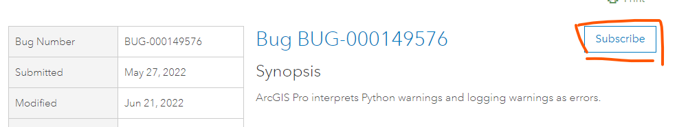

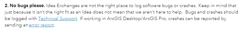

Sorry for the miscommunication on this @philnagel Thank you for mentioning that this had already been submitted as a bug through Technical Support. I read through your comments on that case, and you are absolutely correct - it is certainly not a prerequisite to submit an idea before support can log a bug. In fact, the ArcGIS Ideas Submission Guidelines and Statuses are explicit in stating that ArcGIS Ideas is not for bugs:
This issue is being tracked through the bug tracking system and can be found here: https://support.esri.com/en/bugs/nimbus/QlVHLTAwMDE0OTU3Ng== If other Esri Community members encounter this, it is not necessary to call Support. Rather, use the Subscribe button at the link above - this will set you up for notifications as well as increment the count of affected users in the system which helps teams prioritize issues.
Given the above, this idea will be closed. Thank you again, and we apologize for the confusion in communicating around this issue.

Just wanted to bump the thread to point out that https://support.esri.com/en/bugs/nimbus/QlVHLTAwMDE0OTU3Ng== is now showing as Fixed in ArcGIS Pro 3.1 (scheduled to be available ~Feb 2023).
