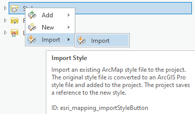

Hi @JohannaKraus2 Yes, if you have ArcMap on the same machine (or really if you just have the ArcMap styles handy) you can import them:
KoryKramer_0-1628878499004.pngKoryKramer_0-1628878499004.pngKoryKramer_1-1628878590746.pngKoryKramer_1-1628878590746.png
https://pro.arcgis.com/en/pro-app/latest/help/projects/styles.htm#ESRI_SECTION1_2D13B0FBB19D49BC9296...
