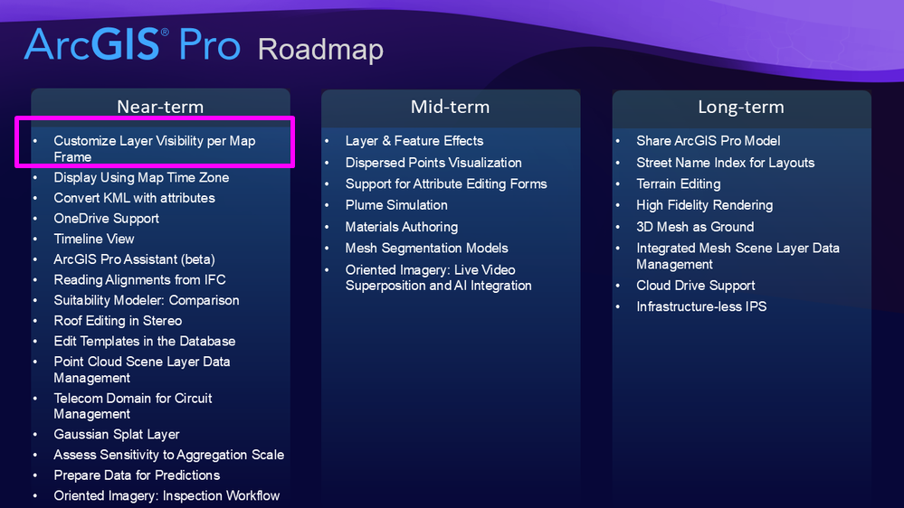

RTPL_AU
@JamesWilliamson
it seems to be in the current Product Plan for near-term.
I'm nervous about the way it will be implemented but agree with the concept.
LindsayRaabe_FPCWA
I'm actually having trouble understanding the request and how it relates to the replied roadmap item.
The roadmap item itself is clear enough, but it's not what I think of when reading the OP's idea. To me it sounds more like you want to lock layers so that they can't be inadvertently changed to suit one Map Frame, which then impacts another existing Map Frame/Layout that uses the same source map? It should remain consistent across all layouts. Is that right?
JamesWilliamson
@RTPL_AU  Could you better describe this road map item?
This does not sound like it would satisfy the same goals, in being able to lock a layer and a style in a specific map frame and sounds like something else.
RTPL_AU
@JamesWilliamson
Nope.  That's up to @KoryKramer  and team.
I'm just a guy with an Esri renewal notice in front of him that hopes that if they implement it, they do it properly without hosing something else in the process.....
AlfredBaldenweck
I think (hope) that the roadmap item refers to this related Idea: Locked Multiple Layouts in ArcGIS Pro
JamesWilliamson
Thanks!
I suspect that this road map item doesn't include these options though.
