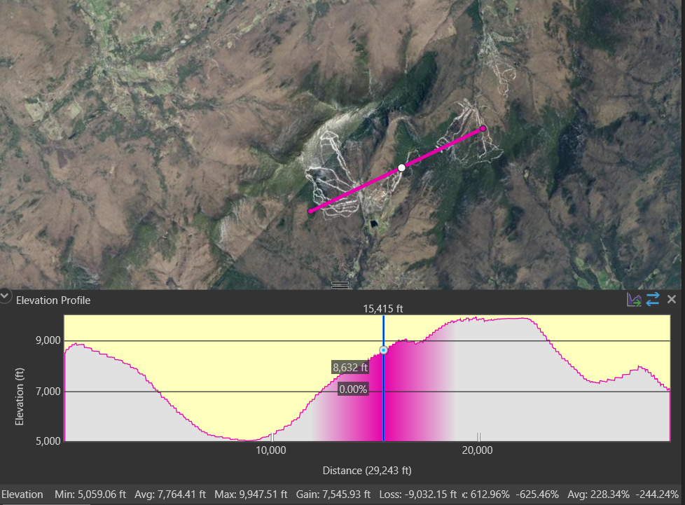

For those on this thread, please check out the interactive elevation profile tool in ArcGIS Pro 2.7 and (7:29) in the ideas in 2.7 video to see the interactive feedback on the map/scene as you slide across the profile graph.  Does this meet your needs?  If not, please let us know what is missing.

DuncanHornby
Hi @KoryKramer
This improved interactive profile graph does indeed work better although I was tripped up by the need to add an elevation layer to elevation sources through the add data button. Once I had done that I was able to draw my line and the moving dot works well and allows me to explore the data.
I do have one comment, the tool does not work if the elevation data is a mosaic dataset.  In the UK public lidar is released through our Environment Agency and they come as  zillion tiff files. So I typically stitch them together as a mosaic dataset. When I tried to use this profile tool it would not work with the mosaic dataset I had to export it as a raster. Now in this case this was acceptable as its just one river catchment so the raster was small enough to work with. It would be impossible if I had the whole country.
I would hope that in a future release this tool would work with Elevation Surfaces that are mosaic datasets built from a bunch of DTM tiffs.
