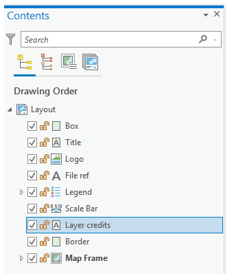

Here I have the map frame locked so that it cannot be selected in the layout while the other elements can be.
Just like when working with layers of a map, you can select multiple layout elements in the Contents pane and hold Ctrl +click the lock to toggle these on/off.
Hope this helps present-day workflows!
