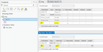

I'm creating a join from Test_FC to Test_table via a common ID field.
In Test_Table, I've accidently set the ID field's datatype to text instead of a long integer.

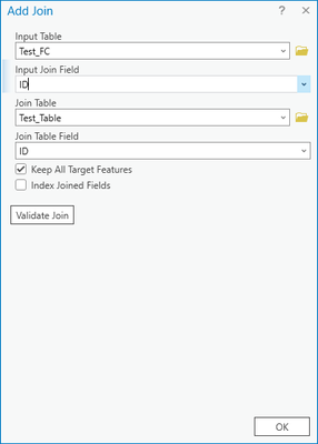

Not knowing about the mistake, I attempt to create a join in the attribute table of Test_FC.
But, the join fails, because the ID field in Test_Table is text, not an integer.

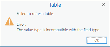

Failed to refresh table. Error: The value type is incompatible with the field type.
That error message is expected.

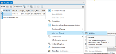

  • The Attribute Table automatically closes -- which isn't something I'm used to seeing.
  • When I try to open the Attribute Table to investigate the join, I get the same error again: Failed to refresh table.

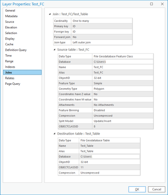

  • I don't see a way to delete the join from the layer Properties:

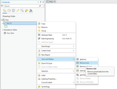

After spending some time clicking around in ArcGIS Pro, I can see that I can remove the join using the layer's right-click context menu.
And that does seem to work -- I can remove the join and open the Attribute Table again without getting the error.
