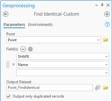

For Find Identical, it's "Output only duplicated records".

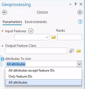

For Union, it's "Attributes to Join --> All attributes except feature IDs"

When I need to frequently run the same tool (or sequence of tools) with mostly the same parameters each time, I use ModelBuilder to create a model with the tool(s) and pre-fill the parameters that don't change between successive runs, and hide parameters that I don't change and don't need to see. That way I only have to change the necessary parameters each time and the rest are already saved. Here's an example a custom model containing only the Find Identical tool with some of the parameters hidden and some pre-filled:
