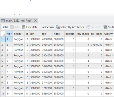

@SSWoodwardI work in ArcGIS Pro 3.2.2 and use a .gpkg produced in QGIS.
1 Classes in geopackages can have fields added or removed: I open the table and would continue with "add" which is greyed out. Similarly when you rightclick on the field name to delete. If you e.g. use calculate and define a new field, it throws an error.

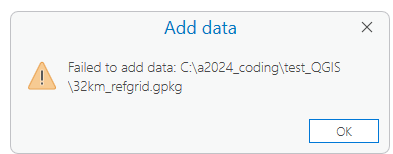

2 Can be dragged into the map: I try to drag and drop from file explorer and get the following message:
CordulaGke_0-1718612252958.png In QGIS it is possible.My gpkg has only 1 dataset, so I assume you would load all in QGIS if there were more. I just tested from catalogue view, and it really worked to add the dataset, so that is great. That changes the main complaint to that you cannot use the right-click-"add to Map" method, only "add to new Map" and adding from the explorer.
