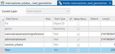

I see that in ArcGIS Pro 3.5 the Add Field button is still gray

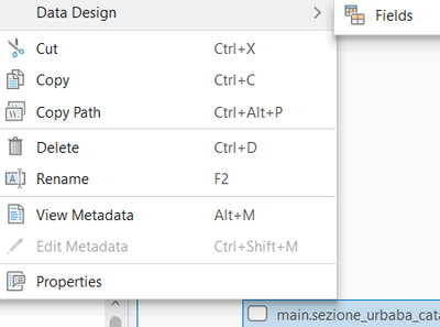

but we can Add (but not remove or rename) Fields using the Data Design > Fields Option

@RobertoRossi Thanks for pointing this out, this was also the behavior in previous versions.  Users can add fields to classes in a Geopackage through the feature class's fields view, its the shortcut from the attribute table of feature layers created from Geopackage feature classes that shows as greyed out when viewing the layer. Opening the fields view of the feature class, or opening the attribute table of the feature class, and not the feature layer, allow you to interact with the data as usual.  This is the bug discussed previously.

To recap:
  1. if I open the attribute table of a Feature class from the Catalog pane, I'm able to Add a new field;
  2. if I open the attribute table from the Contents pane (this is what you call "the attribute table of the feature layer", correct?) I'm not able to Add a new field.
I've also just realised that, if I want to Delete a field I can do it working from Table Tab (or right click on the field name), I cannot do it from the Field View. Finally, correct me if I'm wrong, at the moment it's not possible to Rename a field.
SSWoodward
There are some yesses and some no's here so I'll try my best to help clarify.
A feature class is the actual data in the data source.  A feature layer is an in memory representation of this data that is created when we add data from a feature class to a map.  For Geopackages, a layer in the map is created using a query layer, which uses a SQL query issued to the geopackage, you can view this query in the layers properties.  The return of this query creates the layer in the map.
1. Opening the attribute table of a feature class ( data in the data source as viewed in the catalog ) shows the option to add a field in the UI since users are interacting directly with the data. When there is at least one row in the feature classes' attribute table, the Delete field option is also available in the UI. The delete option is not present on an empty table. I'm currently chatting with the geopackage folks about this observation.
2. Opening the attribute table of a geopackage based feature layer does not support schema operations since you are looking at the result of a SQL query. Query layers generally are read-only, however for geopackages you are able to edit features, but not schema.
Users are able to delete fields and alter field names by passing the feature class in the geopackage to  the Delete Field and Alter Field geoprocessing tools respectively.  Your observation that these functions are not accessible in the fields view is also correct.
