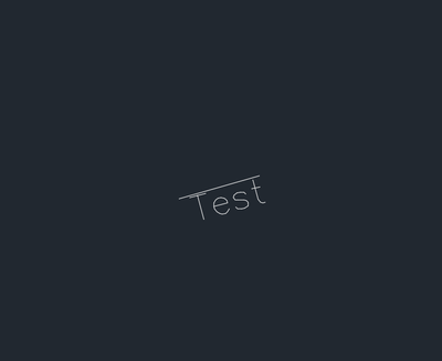

To test this out, I created a "bare-bones" CAD drawing consisting of a single line and "Test" text. I then grouped both the line and text entities.

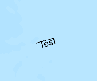

Next, I drag and dropped the DWG into ArcGIS Pro 3.3:
I see both the line and text (as annotation) loaded in ArcGIS Pro 3.3.
