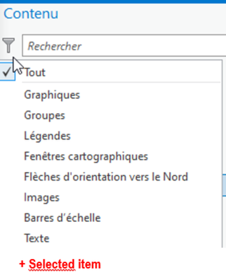

  3. just add a possibility on the filter

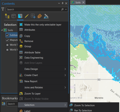

1. Use List by Selection to show which layers contain selections.
2. Zoom to selected features is an option in the context menu under Selection
3. Or, you can use Zoom to Selected features buttons in the lower right part of the map:
In reading this again, I see that you are referring to selected "items". Are you referring to the list of layers in the map Contents, or list of elements in layout Contents, or both? Can you provide some details about the workflow you're doing where it would helpful to filter the layers/elements you have highlighted in the contents?

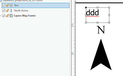

I don't understand what @GregoireS  is asking for? In layout if I select something in the Contents you can right click on it and zoom to select.
Equally  if I click on an element on the layout it becomes selected in the Contents pane.

Ah and of course solution  3 just add a possibility on the filter :

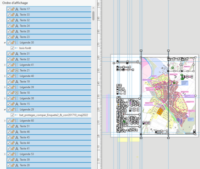

I often have to deal with complex legends which i can't manage with normal legend formatting, so i either transform them to graphic elements, or divide them in many legends (notice that i know all the formatting legend options, i spent days on them). (And then sometimes i also put graphic element to help me for the alignments because i work better with them than with grids and guides).
And also if i have several map windows, each oh them comes with all it's layers in the TOC.
So i think there are many reasons to have a lot of items in the map, so i would say alot of users could benefit that improvement.
An example of the map i'm working on now :
