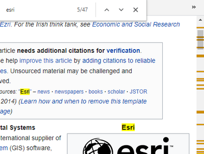

Below, this screenshot of Brave browser's search function illustrates my point 2. I'm sure some softwares has an even better system for that.

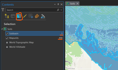

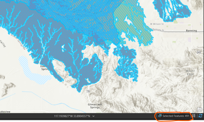

We may need clarification on this idea as there are a few different ways to zoom to a selection and/or show which layers have selections in the Contents pane.
1. Use List by Selection to show which layers contain selections.
2. Zoom to selected features is an option in the context menu under Selection
3. Or, you can use Zoom to Selected features buttons in the lower right part of the map:
In reading this again, I see that you are referring to selected "items". Are you referring to the list of layers in the map Contents, or list of elements in layout Contents, or both? Can you provide some details about the workflow you're doing where it would helpful to filter the layers/elements you have highlighted in the contents?

Belowm, this screenshot of Brave browser's search function illustrates my point 2. I'm sure some softwares has an even better system for that.
Why is it important to see the highlighted elements in the Contents pane all at once?
At the end it's not that important to see them all at once. The main goal is to make easy to reach the item in the content panel, and that could be a way if there are multiple items.
