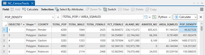

This idea is in the product plan for the ArcGIS Pro 3.6 release! You can use the new Calculate Field Toolbar to make field calculations directly in the attribute table view.
In the toolbar, you can specify the field you want to calculate on (e.g., POP_DENSITY below), the expression (!TOTAL_POP/!AREA_SQMILES!) then click Calculate to run the tool directly in the table view.

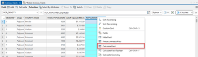

Also, i wanted to add that you can still access the standard Calculate Field tool in the meantime using the right-click context menu on a field in the attribute table (so you don't need to search for the tool on the geoprocessing pane).
