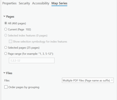

I have a Map Series in which each page is a floor plan for different sites. Each site's plans are grouped by the site address. I've had a request for single pdfs from each site, where the output filename is the address. That single pdf should contain all the pages of floors from the site. I need to do this for nearly 100 sites. Currently the only way I can specify output filenames based on page number or name is to choose the "multiple PDFs" export options. If I use the address as the filename, it will create one pdf and continually overwrite each page with the same name. If I choose the single PDF export option, I have to specify the filename before the export, so I would have to do this manually for all the sites.
Here is a screenshot with an example. I want the pdf to be named "10625 SW 35TH AVE.pdf" and contain all eight pages for the Jackson site. I want to be able to do this as a single export resulting in a single pdf (with multiple pages) for each address group

I think I understand what is being suggested here. Instead of selecting 'Single PDF' and getting one document with many pages and a file name as entered in the File path parameter, you want the document to pull the file name from the Map Series Group of the selected pages. I see this working in a way that instead of only having the 3 current options (Single PDF / Multiple PDFS - Page Name as suffix / Multiple PDFs - Page Number as suffix), you would have additional options available such as;
  • 'Multiple PDFs - Group Name as suffix' (where it would export all pages in a selected Group to a single document with that groups name, and then repeat for any other selected groups)
  • 'Multiple PDFs - Group and Page Name as suffix (where each page would come out individually as per current Multiple options but with both the Group Name and Page Name in the file name.
These options I see being particularly handy for where your Grouping function is identifying separate document areas (in our use cases a plantation) and then there are pages listed for each plantation (i.e. compartments). We want to distribute the plantation level documents to staff and file individually and currently need to merge single PDFs together if run in bulk, or export a selection of pages one plantation (Group) at a time.

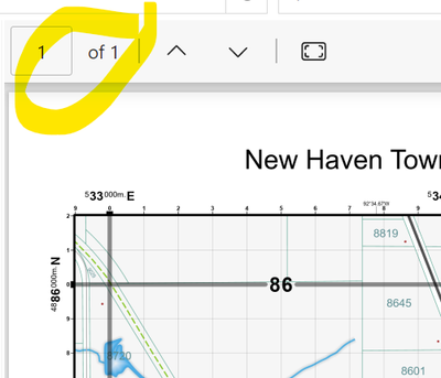

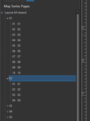

Currently when exporting a map series by multiple page name (group?), it creates a separate single page PDF for each group, but if there are multiple pages in a group, each page in a group is written over the other since it has the same page name essentially. The output is a single page PDF for each group. Not sure if this is a bug or intended, but either way it would be nice to have a "single PDF per group' option where each group is a single PDF based on the group name with all the pages in that group based on the maps series.
Otherwise you have to select the pages in the group under the map series button on the table of contents, go to export as a single file, re write the file name, export, reselect the next group etc etc. Which for more than a few groups gets to be painful and an all day sort of task.

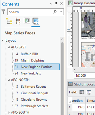

Have you considered Python Map Automation?
Groups are based on a field in the index layer.  You can simply query for each group to create a selection set and use the selected export option.
Here is a snippet of code for the above project:

I understand that you may not be familiar with Python map automation.  Our APIs are designed to help customers extend the capabilities of the UI while avoiding overloading the UI with options. But that is not to say we won't consider improving the export options in the UI.
The script could be modified to iterate through each unique "group" value and do the same export without having to hard code the values in the script.  I kept it very simple so you could see the logic vs the interface.
