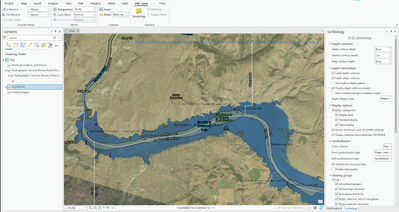

GuyNoll
Hi @MarcelSt-Germain
I have ArcGIS Pro 3.1.1 installed, no Maritime extension.
I just drag-and-dropped US5OR37M.000 that I downloaded from NOAA  U.S. Office of Coast Survey (noaa.gov) ENC site as part of the zipped current ENC for USCG 13th District. I then right clicked the file and 'zoom to layer' to get this view in my Map window as well as the ribbon change to add "ENC" functions.
When I click on the "Symbology" in that ribbon, I get a change on the right-hand side per below, and changing the Transparency in the top-middle gives me changes in the Map window, too.

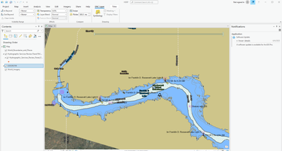

MarcelSt-Germain
@GuyNoll  @ruslanmarmalyukov
Hi, Still not working for me.  Like always, ESRI complicate what they have made simple before.
Effectively, nor drag and drop nor add let S-57 layer show in my project.  I finally try in a blank project and I saw raster map of my ENC. Even if I copy and paste the layer on my project, nothing show after "Zoom to layer". I try changing the projection to Nad83 like in my test projection, without success. I try to remove all layers except the ENC one, still the same.  Even, drag and drop the same ENC doesn't work.
So not very useful for reference.  Also, no way to make calculation nor choosing the only file we need.  It's just an ENC viewer not useful for reference since you can't load it on a project.
In arcmap, you can load the layers you need and only them, put the symbology you need and show label you want.  We doesn't need an ENC viewer. I always use it to show if change are made in my project with, by exemple, labeling the sound_pt in meter and feet.
Until ESRI finally give us the ability to load ENC, like in arcmap, have to complicate our life with Pro plus a copy in arcmap.
