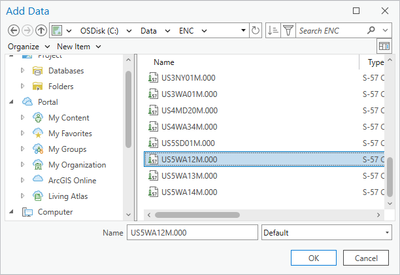

CraigTGreene
@MarcelSt-Germain
Hi Marcel.
You can load ENC from version 3.1 forward. You use the Add Data button to browse to a .000 file to add it to the Contents pane.

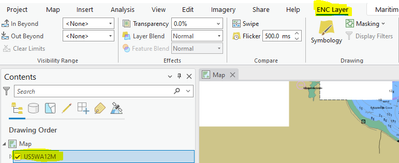

If you click on the ENC in the contents pane, you will see a new tab called ENC Layer.
From there you can access the Symbology pane, which provides S-52 Display Parameters.
Hope this helps.
