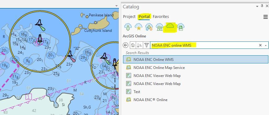

There are a couple of ways to view S-57 in ArcGIS Pro.
1. Add the NOAA ENC Online WMS to ArcGIS Pro. You can do this from the Catalog pane by clicking on Portal, then the ArcGIS Online button and then search for NOAA ENC online WMS.
2. Use the Import S-57 to Geodatabase tool to import S-57 to a GDB (this requires ArcGIS Maritime).
https://pro.arcgis.com/en/pro-app/latest/tool-reference/maritime/import-s-57-to-geodatabase.htm
We will be sharing a lyrx file that contains maritime symbology soon, which you can use with the geodatabase.
I understand that many people in this thread are really asking for the S-57 Viewer capabilities, which were available as an add-in in ArcMap. I also understand that the methods I mention above may not satisfy every use-case.
I just wanted to clarify that there are currently ways in which you can view S-57 in Pro that do not require custom development.
