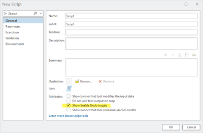

This is implemented in ArcGIS Pro 3.4 Custom script and model tools have the ability to enable undo, and you can add the enable undo toggle using the new Attributes property, "Show Enable Undo Toggle".
With this attribute set, the Enable Undo toggle will display at the bottom of the tool dialog.
Your Python script tool's execution code must use the arcpy.da.Editor class with the editor workspace set to the geodatabase or workspace containing the dataset being edited. When your code calls the editor startEditing function make sure the with_undo argument is set to True or left blank, otherwise the edit will not be able to be undone after the tool runs.
