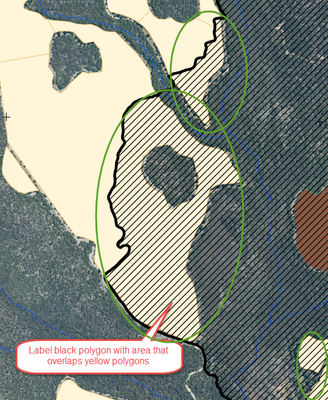

I've been experimenting with Arcade in Field Maps and are loving the use of Intersect and FeatureSetByName for calculating values based on feature intersections with other layers.
I wanted to take this a step further with labels in ArcGIS Pro (though would be good in ArcOnline too) where a feature is labeled based on it's intersection of another layer. For instance, a point feature inherits the name of an underlying Plantation polygon, or a fire boundary polygon labels with the total area of intersected vegetation polygons (instead of having to generate new polygons through an intersect and labelling those).
