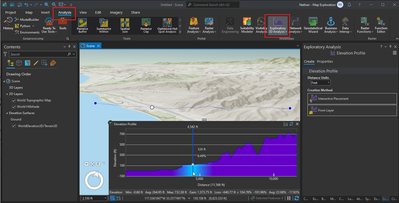

Hi all,
There are a number of ideas on this page, which is great. I wanted to see if you'd had a chance to try the new interactive Elevation Profile tool in ArcGIS Pro, to see if some of your workflows can be met.
https://pro.arcgis.com/en/pro-app/latest/help/mapping/exploratory-analysis/interactive-elevation-pro...

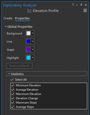

  6. Full control over appearance - supported (limited set of properties for the displayed graph, per below image, and full control by exporting to a data table and creating a Chart)

Screenshot of profile graph display options (per #6)
I hope this helps get you started on evaluating the interactive profile graph in Pro!

Simonez
@NathanShephard thank you for posting this. However, I cannot find this tool. The only tool available from the Exploratory 3D Analyst menu is "Object Detection". Just updated ArcGIS Pro today (personal use license).
Referring to this page
Any help would be appreciated
