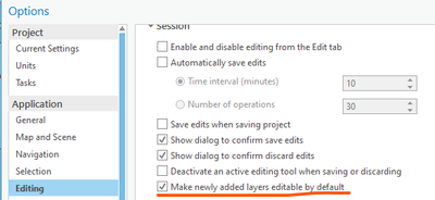

Because you said "So, we have to uncheck from the selection et editing pane, all features and only check the one we need." I wanted to make sure that you were aware of the Editing Option "Make newly added layers editable by default."
If you uncheck that, then any new layers added to maps will not be editable by default.  I understand that this does not solve for many maps that already contain many layers, etc. but just wanted to make sure you were aware of that setting.

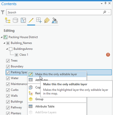

If multiple layers are already editable in List By Editing, you can right click on a single layer and choose 'Make this the only editable layer'

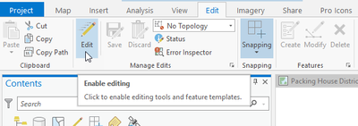

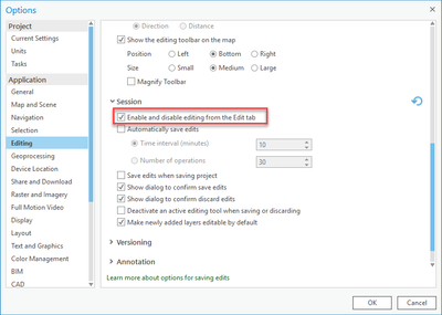

You should also be aware of the option to Enable and disable editing from the Edit tab option for the application:
This option will disable editing at the application level until you click the Edit button on the Edit tab:
More info on this option: https://pro.arcgis.com/en/pro-app/latest/help/editing/enable-and-disable-editing.htm

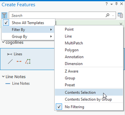

One more tip that's not specific to selecting or modifying features, but might be helpful for creating features is the filtering capabilities of the Create Features pane. For example, you could filter to only show the templates for the layer that's currently selected in the Contents pane:

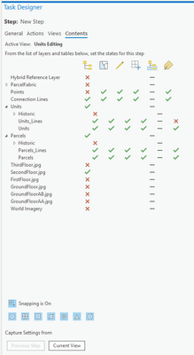

You can use a step in a Task to set all the layer properties you need in a single click:

Thanks but, not what I have in mind.  First, the right clic only make it the only selectable, not at the same time the only selectable.  So need more step to do in place of selecting the feature, clic de button and do the job.

The Task is also not helpful since that mean many task to do so check and uncheck selection and edition takes less time to perform.
