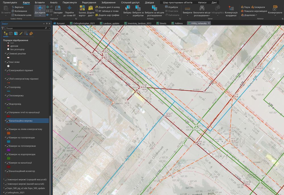

FedirBalaba
I vectorize utility networks using raster data from topographic and geodetic surveys by comparing the actual location of manhole covers on a high-resolution orthophoto. I've seen a similar drawing function in AutoCAD and would like to implement it in ArcGIS as my main software.2024-11-08_083931.jpg2024-11-08_083931.jpg
Scott_Harris
@FedirBalaba Like @AlfredBaldenweck mentioned, you can already do this with Group Templates.
https://pro.arcgis.com/en/pro-app/latest/help/editing/create-a-group-template.htm
Here is how to create a basic one - but they can get more complex by adding multiple builders:
They also work with a Utility Network:
https://pro.arcgis.com/en/pro-app/latest/help/editing/utility-network-reference-for-editing.htm#ESRI...
