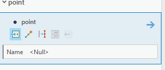

The point template, with the Name field exposed to pre-fillThe polygon template, with the Name field exposed to pre-fill
The group template, with the Name field of the point layer exposed to pre-fillThe group template, with the Name field of the polygon layer exposed to pre-fill

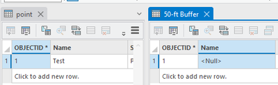

The group template, with the Name field of the point layer exposed and filledThe group template, with the Name field of the polygon layer exposed but not filled out
Resulting featuresThe attributes of the resulting features.
As you can see, the attributes are not linked.
