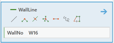

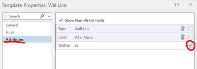

Hi all,
I’m not sure whether this is part of a recent update or something we’ve just missed so far in ArcPro (myself included).
I’ve just discovered the option to prompt for table attributes as part of a template. Once you check the box in the template properties, the attribute appears in the Create Feature window as an input that you can easily change for all subsequent features (see pics).
It’s not exactly the same as having the attribute window pop up after each feature, but I’ve found it convenient enough.
