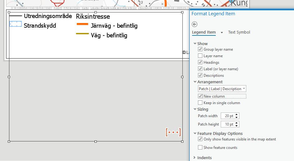

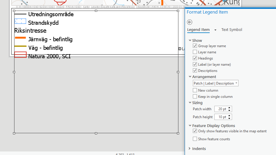

Hi,
I am working in Pro 2.3.1 and maybe this is fixed in later version but this is how my legend behave
I have Arrangement - Fitting Strategy - Adjust Columns
The only change between the alternative is that I check New column för Järnväg.
Why is the element at the back not visible in Alt 2.? There is space for it.
Alt 1.
Alt 2.
