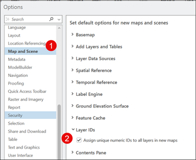

This idea has been implemented in ArcGIS Pro 3.6 release. Thank you all for your valuable inputs.
To have layers have IDs assigned automatically, go to the Project >> Options dialog; switch to Map and Scene tab and have 'Assign unique numeric IDs to all layers in the new maps' checked.
pls note that this option won't affect your existing maps.

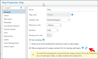

Also, there is a new option on the map's Properties page to reset existing layer IDs and assign sequential values (starting from 0) to existing layers.
