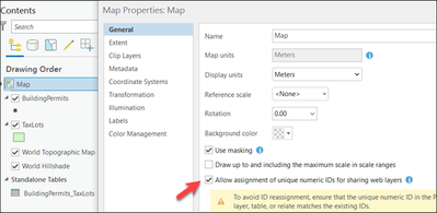

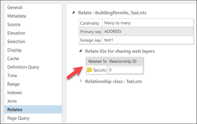

TanuHoque
Status changed to: Implemented
Implemented in ArcGIS Pro 3.3. You also need ArcGIS Enterprise/Server 11.3 or above too.
Once you enabled this 'assignment of unique numeric IDs..' option on a map's Properties page
... you will see text box(es) in the Relates tab under each relate, that allows you to provide user defined IDs to each relates.
Help: https://pro.arcgis.com/en/pro-app/latest/help/sharing/overview/assign-layer-ids.htm#ESRI_SECTION1_42...
Thank you all for your suggestions and contributions.
