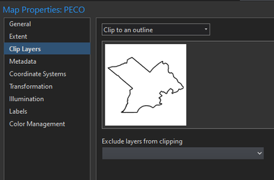

I clipped my map frame (basemap) to a layer (AOI polygon).

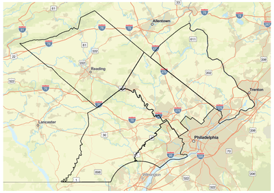

Used the "Download Map" button on the ArcPro ribbon... yet when I open the output .vtpk in Pro it appeared to use the extent (bbox) of the poly feature rather than the clipped extent.
Below is the output .vtpk (much bigger area than desired)

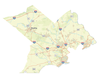

I need the .vtpk to only include the basemap tiles that fall within the poly boundaries (honor the clip) like screenshot below.
Is this possible??
