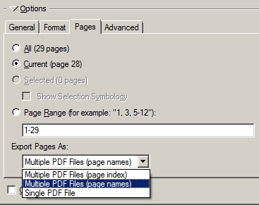

It would be great if it would be possible to create custom formats for the file names that are produced by the data driven pages feature. Now it looks like this in ArcGIS 10 (ArcMap):
0EM30000000CrzN
You can choose etiher index, name or page number to be included in the file name

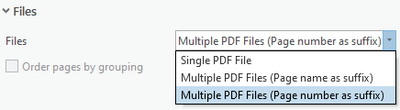

Currently the files name option in the Export Layout MapSeries Pane includes only three options as follows:
Could we have a new option: Multiple PDF Files (Page Name as File name). We use a field for naming the output file (pdf).  Having only a suffix option means we have to delete the layout name after producing (exporting) the layout files.

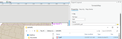

It's a bit of a hack, but if you leave the name blank, then the page name as the "suffix" will simply be the pdf file name.
In the image below you can see that I'm exporting to my C:/EXPORTS folder and I leave everything after EXPORTS blank.  When I choose 'Multiple PDF Files (Page name as suffix)' the parameter changes to C:/EXPORTS/.pdf and the separate pdfs are created using only the Page Name for the file name.
(In this case, my page name is 5).
