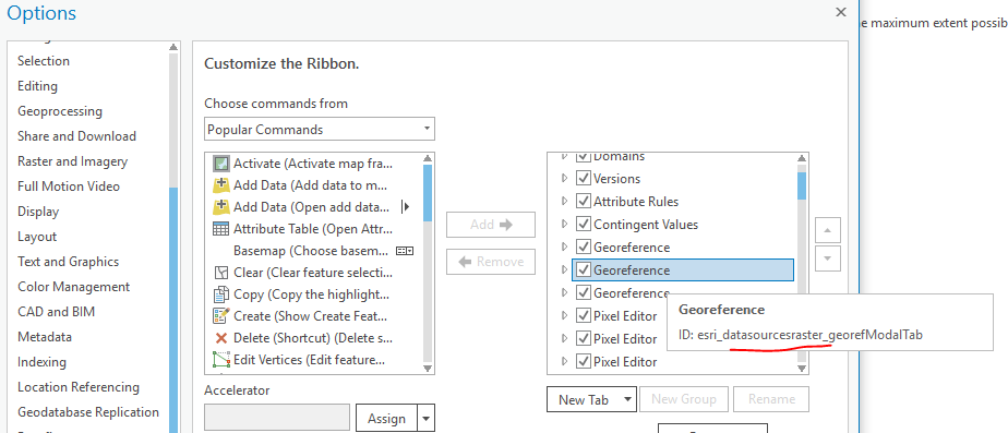

ArcGIS Pro has very many tools.  They made it easier to find all these tools by only displaying context-sensitive tabs.  However, it is very difficult to customize the ribbon because there are so many tools and tabs, which some seem redundant.  For example, there are 3 georeference tabs under the "Main Tabs" heading.

Pro teams understand that the current customize experience has room for improvement and have been making some changes to make it better in 2.7.  For this comment
that will be addressed in ArcGIS Pro 2.7.  Here is a snapshot of 2.6.x that demonstrates what you're talking about:
The reason this happens is that there are different contexts where georeferencing shows up - mostly for raster or CAD/BIM.  In 2.7, the duplicates are removed and commands are grouped under a single Georeference node with more description added to help the user understand which commands are which.
In the screenshot below, you can also see that Pixel Editor is a single node as opposed to above where we see three instances.
