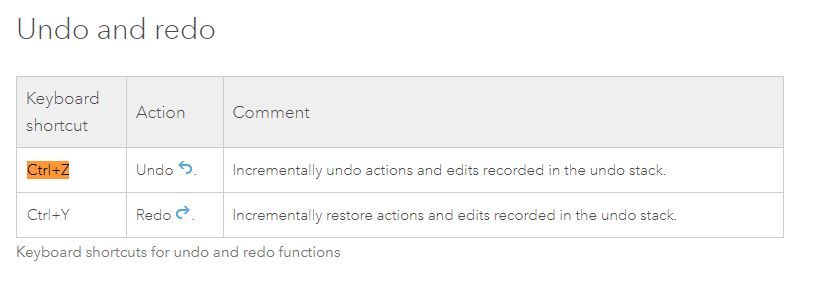

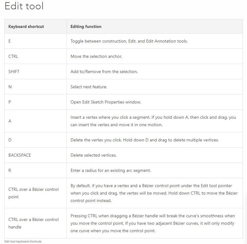

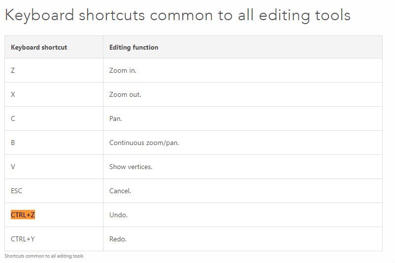

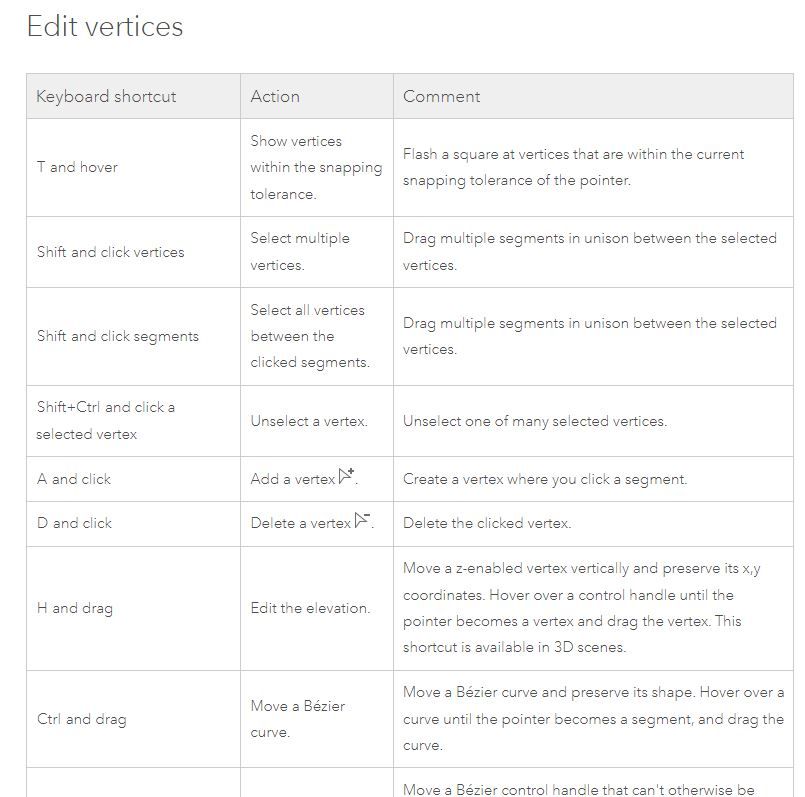

Hi Paul - I'm looking at the ArcMap shortcut keys for editing and vertices (see images below) and they're identical - even with the factory default of CTRL-Z.  I'm wondering if the CTRL-Z shortcut key got reassigned by local users in the ArcMap days to delete vertices?  As it is, it does make sense that a CTRL-Z (which in an undo) would undo the edit. If you use the D key and click a vertex, it deletes a single vertex.  If you hold down the D key, you can delete a group of vertices using a lasso.
