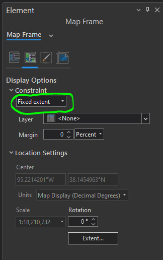

Hi Robert,
I think you get the result you're looking for by setting a  "Fixed extent" constraint on the map frame.
The map's extent and the aspect ratio of the map frame should remain constant as you resize the map frame.
Hope this helps,
Tom
wayfaringrob
No, I've tried that, not what I'm looking for. That helps if resizing from a corner and you're looking to keep the same proportions, but that's about it.
