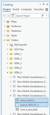

In the Catalog Pane, I've selected multiple items in the same geodatabase/workspace:
I'm not able to drag those items to the map. Dragging/dropping has no effect.
I would like to drag those items to the map simultaneously, rather than dragging one at a time, similar to what I can do with the Add To Current Map context menu option.

I did a quick test with ArcGIS Pro 3.2 and an Enterprise Geodatabase at 11.1 and I am unable to reproduce the issue. I am able to drag multiple feature classes into a map at once. Can you please confirm your Enterprise Geodatabase version?
I don't have access to an enterprise geodatabase on the computer where I have Pro 3.2 installed.
The computer that does have access to an enterprise geodatabase (Oracle 18c 10.7.1 EGDB) has an ancient version of Pro: 2.6.8. Dragging multiple FCs from Catalog does seem to work with an EGDB in Pro 2.6.8.

It's strange. Previously, I was able to reproduce this issue multiple times using a mobile geodatabase.
But I happened to reinstall Pro 3.2 today, and now I can't reproduce the issue, even when using the same mobile GDB data.
So I guess this idea can be closed.
I don't have access to enterprise geodatabase data in my Pro 3.2 environment, so I have no way to test that. Best guess is enterprise geodatabase data works too.

Thank you for retesting your case.  I can also confirm that in ArcGIS Pro 3.2, drag-dropping multiple feature classes and/or tables to the active map (or to it's Contents pane) works as expected.
This idea thread is closed as you suggested.  Thank you again for your feedback.
